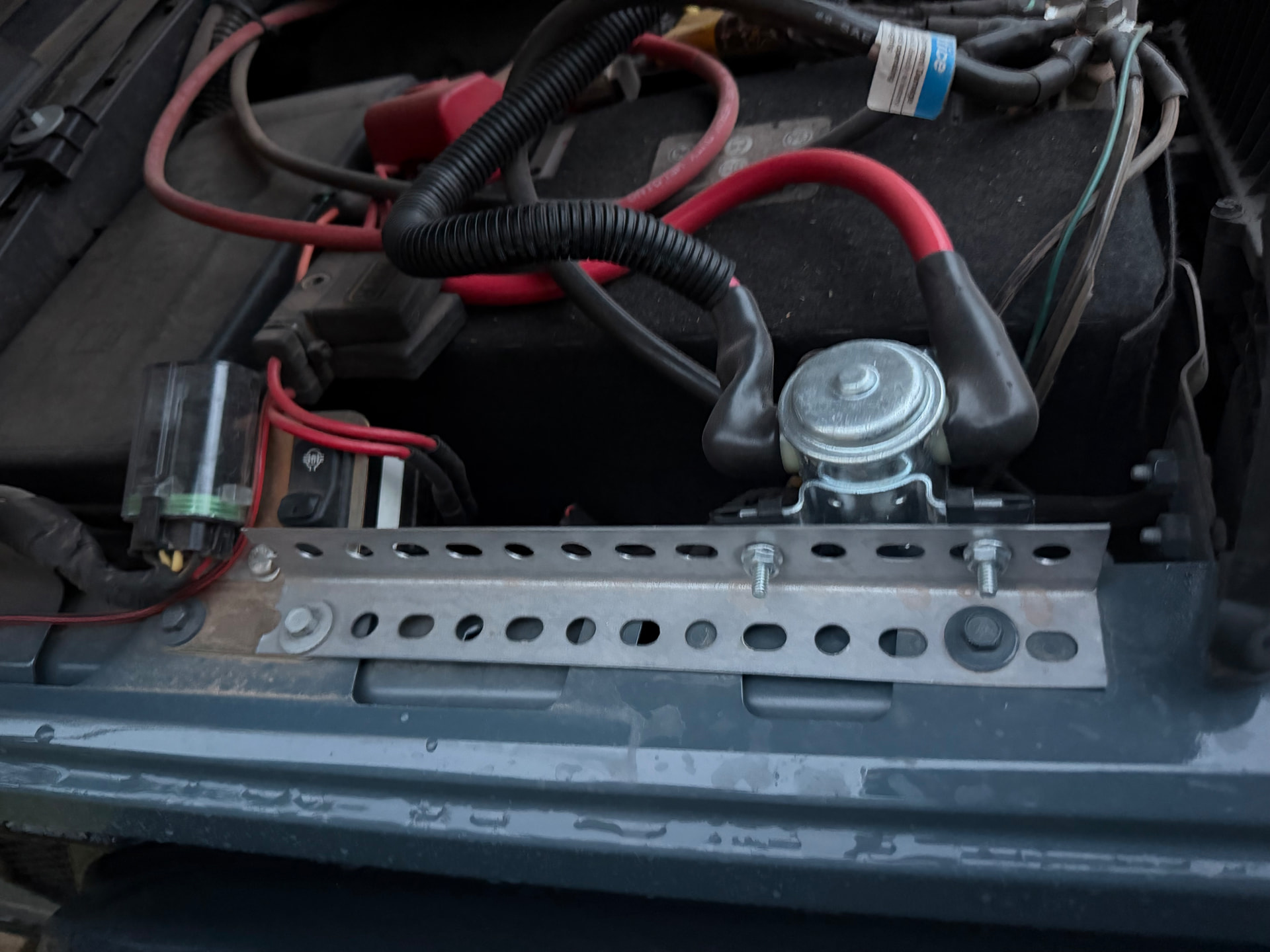

The 1.5x the weight of your vehicle is a good rule of them. I’d definitely go synthetic line. And the last tip I would have which I think many people skip over is to install a power interrupt kit. This makes it easy to not have to run the winch “hot” all the time. A good thing in case of damage to the front end it won’t activate the winch, or, if your winch solenoid gets stuck in the “on” position you can kill the winch with a switch. The Interrupt kit is simply another solenoid you install under your hood. You connect your battery to one side, the winch to the other, and then a small switch wire to it and place the switch under the hood or in the cab. Then, when you need your winch, you can flip a switch and its “hot” and live, or, if you need to kill it, you can kill power to it through the switch. I’ve seen videos of solenoids getting stuck on and its a big disaster–it can catch fire, damage your vehicle, damage a vehicle you’re winching, etc…

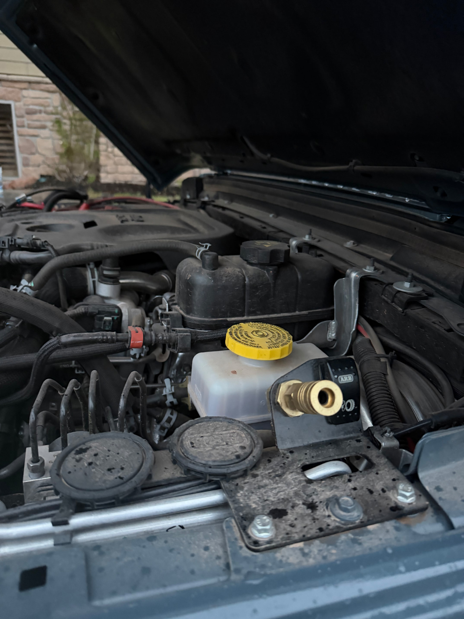

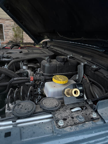

Here is a photo of my winch power interrupt solenoid wired to a cab aux switch. I also have a kill switch for my front locker as shown on the left as the locker button is an aux button and can technically be activated anytime. I keep it off day to day and flip it on once we hit dirt. The rear locker has a nanny control only when in 4L—but front is wired directly. I also have my on board air coupler under hood.
