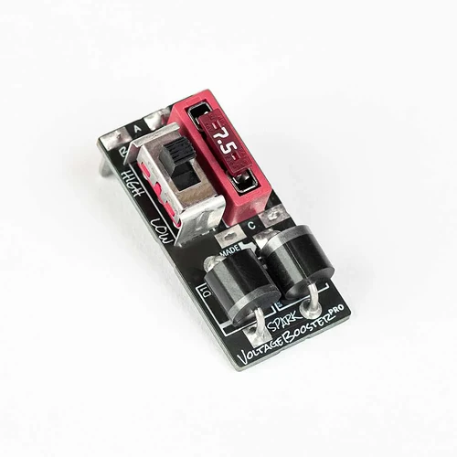

Anyone have experience or need to adjust alternator voltage to accommodate an AGM battery? I recently upgraded the ‘12 Tundra with an Odyssey 27F AGM battery. So far I’m happy with the new set up but stock, the Tundra only puts out about 13.2 volts. AGM requires 14+ volts to stay fully charged. I recently purchased this product to help fix this issue.
Anyone have experience with having to adjust voltage for an AGM or this product in particular?

Just want to provide an update. The VoltageBoosterPro has been installed and works as advertised. Super easy install and extremely easy to either toggle between high (~14v) or higher (~14.5v) voltage, or remove it all together and revert back to stock any time.
The device is very well made and seems like it will last. The only minor odd ball thing is it uses a larger sized blade fuse as opposed to the “mini” fuses that come stock with the 2nd gen Tundra.
Although about $100, I feel it’s worth it and you’re supporting US (TX) product and small business.

The issue we have running lithium’s and AGM’s is our alternator voltage is set for Lead Acid batteries. All we have to do is change the regulator spec up one volt.
OR we drop the voltage on the sensing circuit. Today cars monitor voltage the same as old school and they monitor the fuse block voltage. If we lower the voltage slightly at the fuse block, it tricks the alternator into raising the voltage to compensate.
Diodes will cause a .5-.7 volt loss. Putting a diode across the alternator ignition sensing circuit (alternator fuse) is one of the easiest ways to do this. The alternator draws ~7amps through there so, all you need to do is make sure the diode you install there is properly sized.
This company web site cautions about using the GM “diode fuse”. This will work except you removed the fuse part and its not high enough rated for what your doing but, it achieves the same thing.
Scott. Thanks for the clarification and details.
I thought about the diode but seemed like cheap insurance to go with the VoltageBooster. I also like the option of running “low” and “high” voltage with the slide of the switch. This seems like it would address the heat aspect if concerned with that. I also saw a hack that used the diode, but added a fuse inline which is cheaper and overall, seemed similar to this product, without the build quality
Nice to better understand the whole battery and charging process while having a couple of solutions (diode, VoltagePro or just stock) that have been in use for some time.
In my opinion, the diode method is the best way to go. You could have a custom alternator built with higher voltage output or have the PCM (in some) programmed for higher output but, you cant easily go back.
Even though I can make my own, its just easier for me to buy one of those. What I really like is the voltage switch. Different vehicles will have diffrent output voltages. With the switch I can choose the optimum on my build. The optimal safe area for AGM is 14.4-14.8 with 15 at max.
