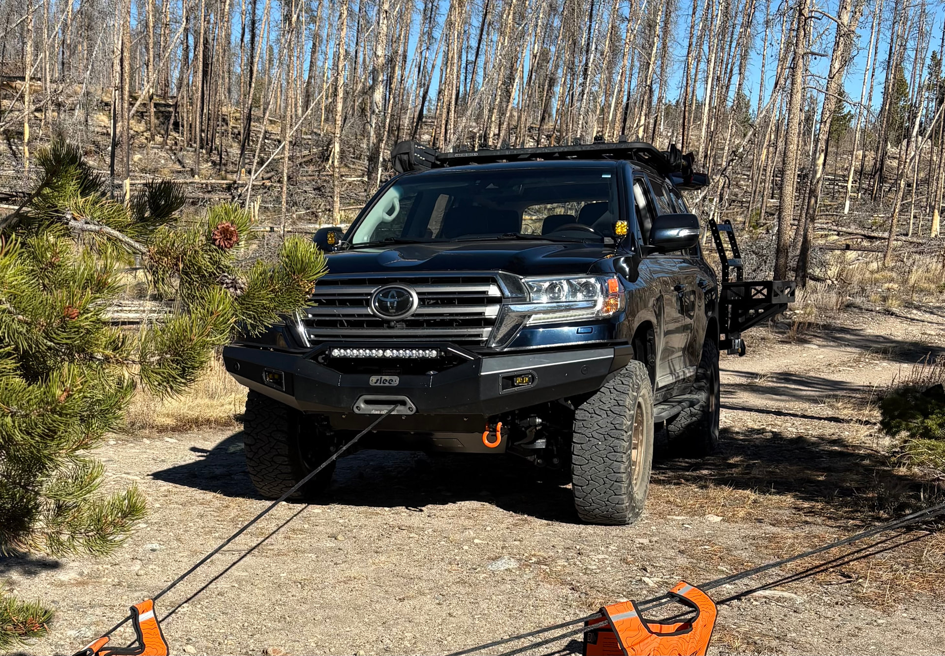

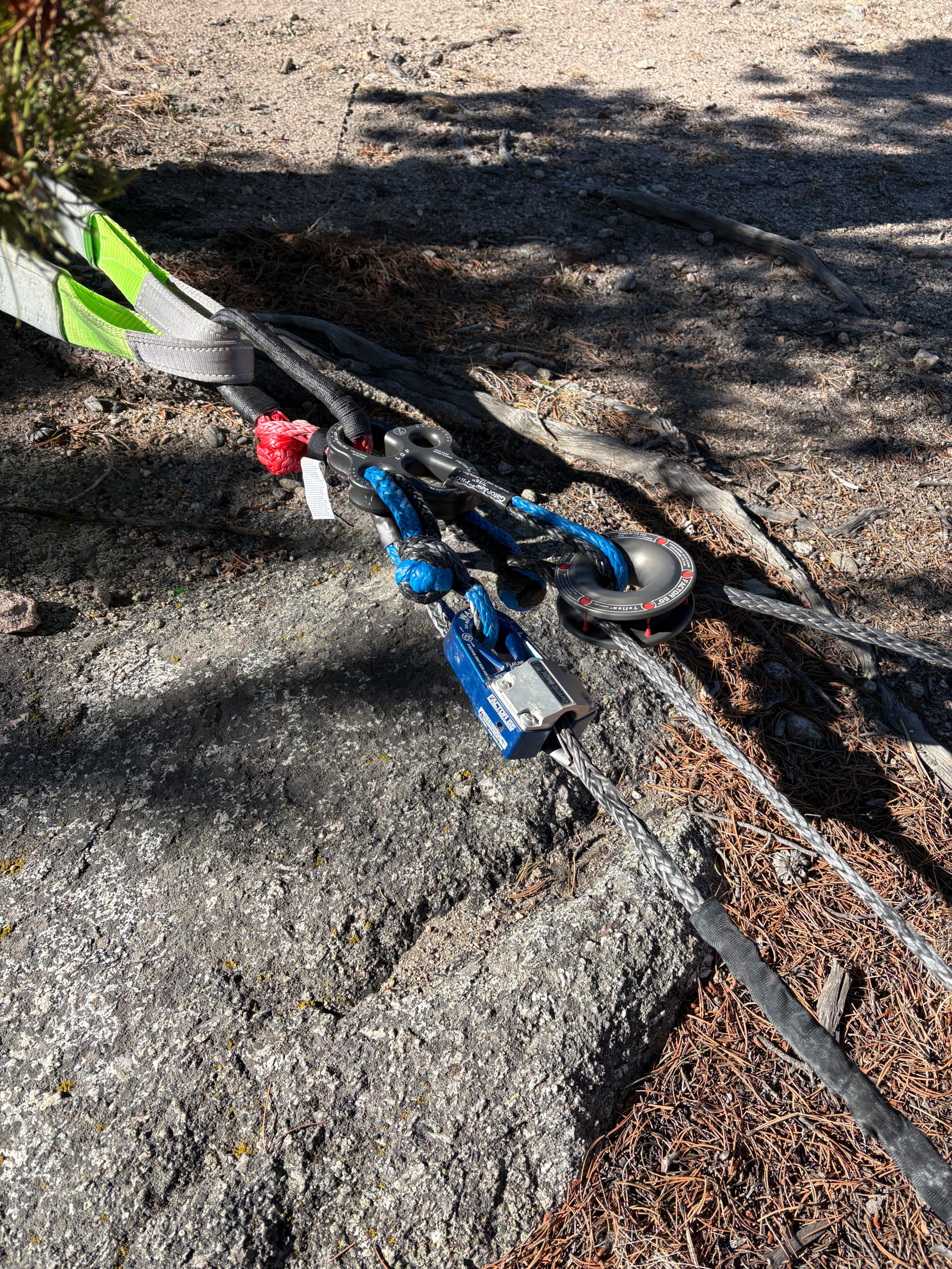

Testing new gear
Setup a 3:1 pull using Factor 55s LDP(Load Distribution Plate). Amazing piece of gear, possibilities are endless with this​:+1:

In your first photo, the double winch lines on the right, are you using a secondary pulley wheel?
Yes, in this case I go to the first tree and then back to a second tree using two pulleys and then back to the LDP. You could also instead of going to a second tree attach to another vehicle and then back to the LDP if you were pulling out another vehicle. Hope that makes sense.
Yes, it does make sense. I’d figured you had to be using a secondary pulley wheel for self recovery(testing purposes). Which means having one pulley wheel is good, but 2 would better. Thanks for sharing.
