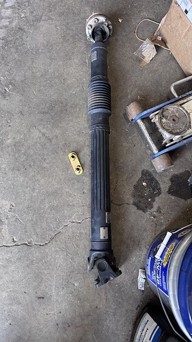

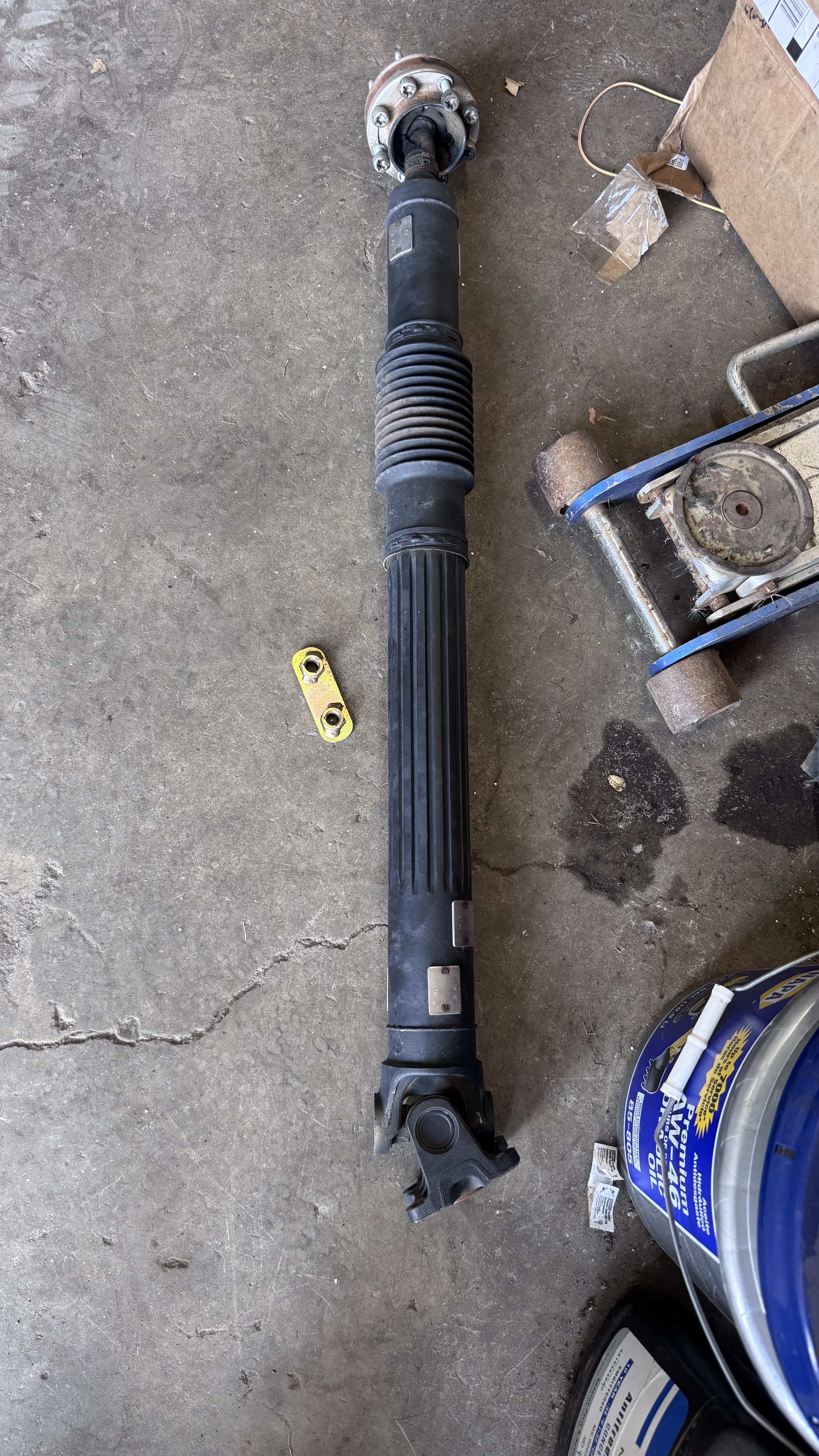

At Skyline, I realized my front driveshaft was damaged and making a pretty bad clunk. I ran part of the trail in two-wheel drive and used four-wheel drive only when needed. Afterward, Jeep West outside Portland had a 392 takeoff shaft they were able to install and get me back on the road. Great guys, and they really helped me out in a pinch. I’ve since ordered an Adams driveshaft as a permanent replacement.

How did you damage your front drive shaft?
It was overdue. When I lifted it and put on the shocks, etc, I never swapped the front driveshaft from factory. I got a lot of miles out of it, though. The factory driveshaft doesn’t handle lots of flex as there is a boot on the transfer case side that wears out. Once the boot cracks or breaks due to off-roading and flexing it just started clunking indicating it’s imminent failure. There is a rzeppa CV joint inside that fails.
The first trail of the trip near Boise had some flexy spots and that’s what likely did it, then as soon as I went into 4wd on day 2 it was making the noise. Photo below shows where the boot had been damaged.
