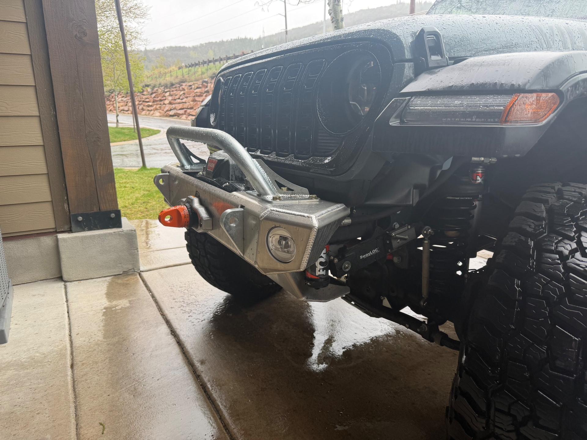

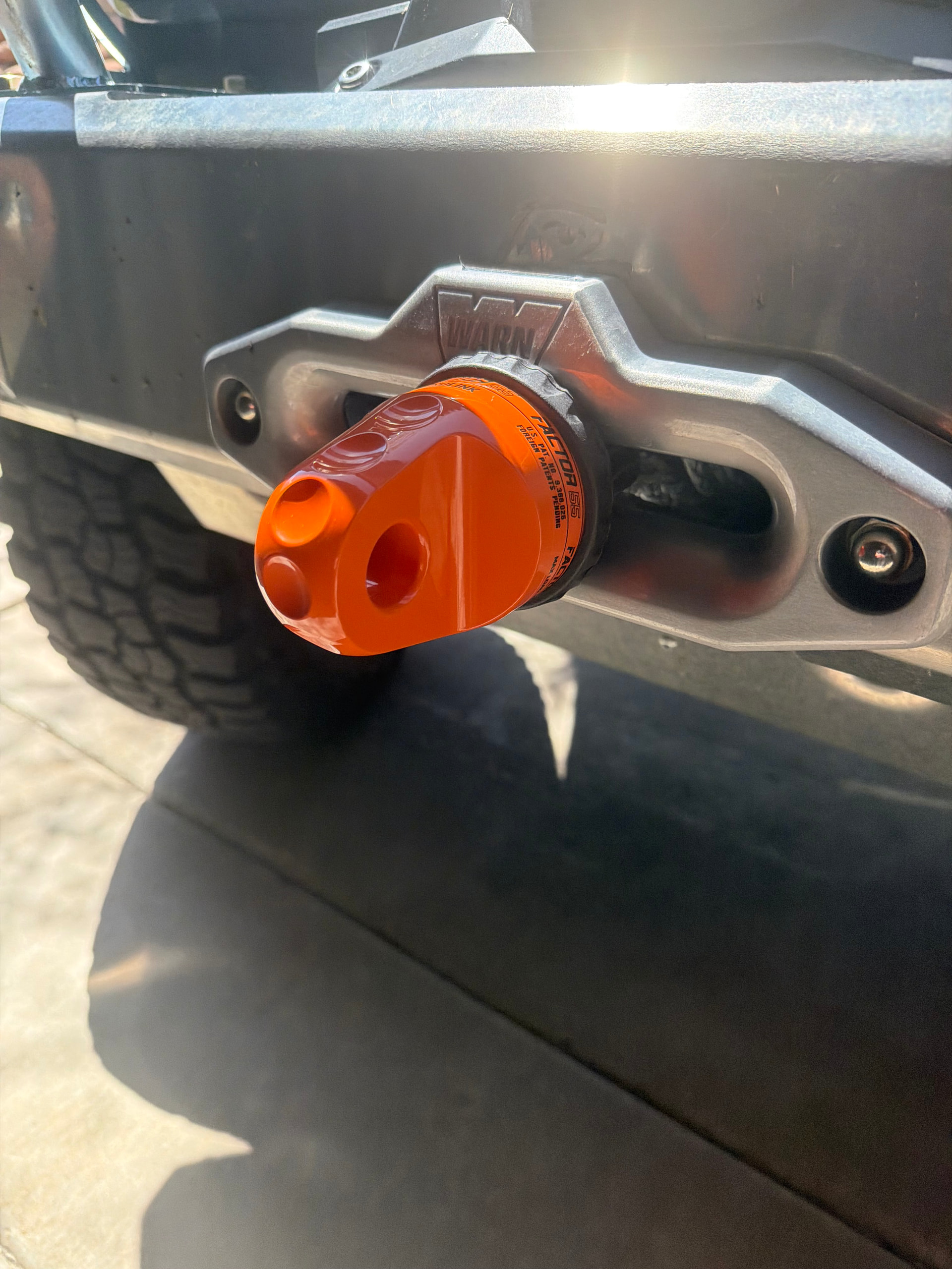

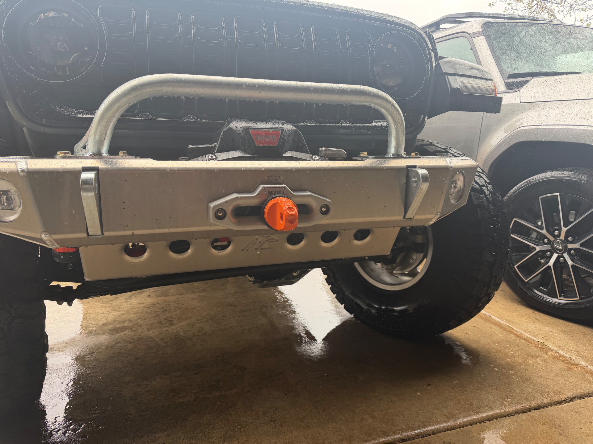

Last week I picked up a Factor55 thimble and finally replaced the warn hook to keep the system closed. Will pair well with the soft shackles and will still fit my Crosby shackles if needed.
